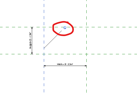

thanks for the family.  Greatly appreciated.  Every time that I Stretch the line after I load into project, the other side shoots out a big distance and the same when I try from the other side.  Any thoughts?
Nachricht 12 von 15
als Antwort auf: 55chuteT9MXS
Pin the Left Ref plane.

Hi, still not getting it.  Pinned one of the reference planes and still shoots out at either side.  Including the family
You are correct. It only stretches properly when placed on a sheet.  When place on a view, you would have to enter the line length to avoid explosion.
So you will have to make a compromise: either have the line stretchable and enter the labels via properties; or enter the labels on screen and enter the line length via properties.
