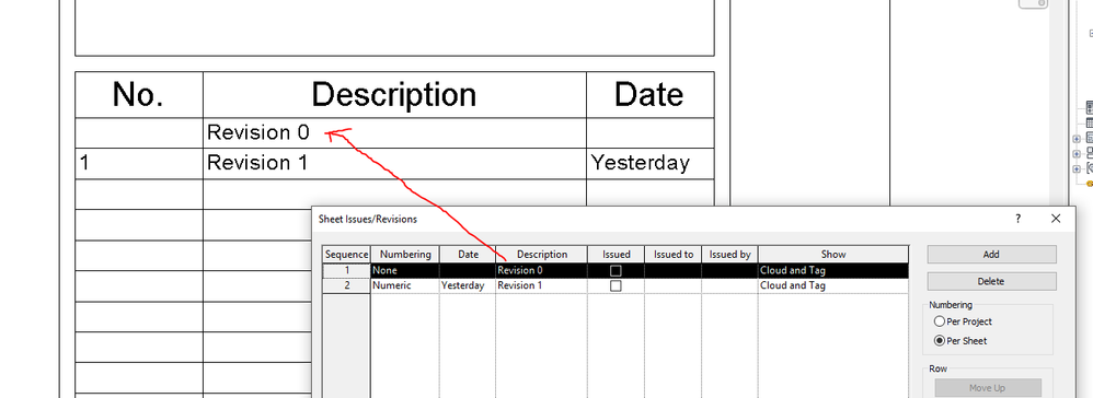

Best I can do without adding visibility for an additional "0" is below:

@rsahayUZMK9 wrote:
You have the 00. But you will also see revision 0 in the schedule. A thought - use text for the 00.
i don't want to see Revision 0 in the schedule!
If i create a revision .00 in the project, to see this number in the title block name sheet i need to set visibility of revision. If i set visibility of revision i see revision 00 in the schedule...It's a loop Smiley (zwinkernd)
Yes i understand...So i cannot do in another way...The bad thing is that i cannot modify the schedule with filter...But with filter of visibility?
