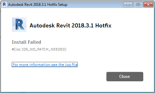

Hi all,
Info:
Comp/Graphics card: Win 10/NVIDIA Quadro P500
Several members of my team are having troubles installing the above mentioned update for Revit 2018.
I've supplied them with a link directly to the installer placed on our servers - I used the .exe file myself to perform the update om my computer without any errors.
This update does not appear in the Desktop App, thus the reason I supplied an .exe file instead.
The error below is what they're getting:
I've tried searching the interwebs for queries like this, but i haven't been able to find anything regarding this issue.
I can supply a logfile aswell, if this would be helpful with the trouble shooting.
Thx in advance.

Cheers for the reply and the link. I had been looking through that already :leicht_lächelndes_Gesicht:
I just had a colleague re-install Revit 2018, and afterwards the 3.1 hot fix appeared in the Desktop Manager and installed successfully aswell.
Don't hope I need to do this on all computers :grinsendes_Gesicht_mit_lächelnden_Augen:
