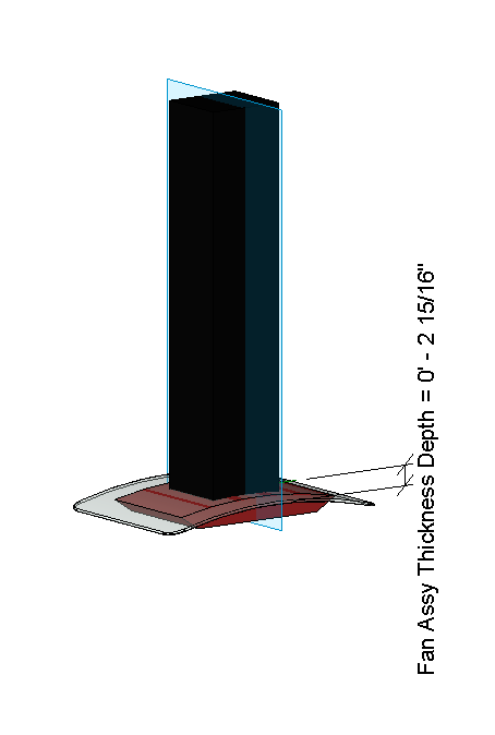

Hello Folks...  I just wanted to follow up with you regarding my progress with my Project.. I did model the vent hood iun REvit with the exception of the glass which I modeled in Autocad then imported into my Vent Hood Family.. Attached are copies of the renderings and family editorCapture.PNGCapture2.PNGCapture3.PNGCapture4.PNGCapture13.PNGCapture14.PNGCapture15.PNGCapture16.PNG

WOW! If I could give you double, triple, and quadruple Kudos I would do so! Well done!!
