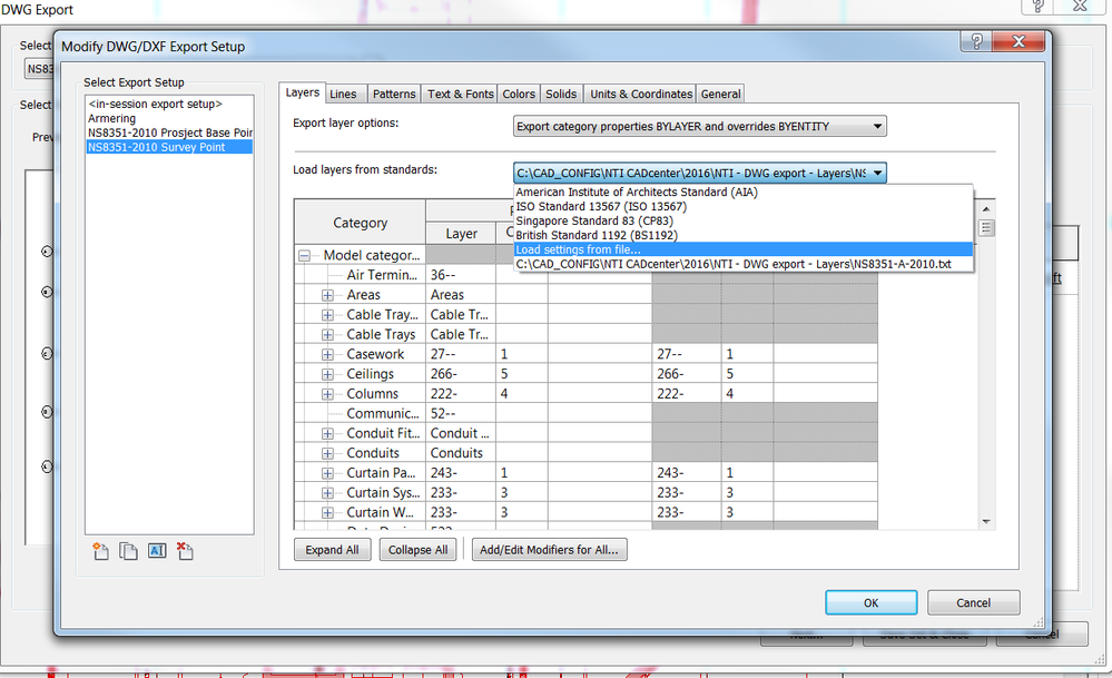

Hi
Im having trouble exporting sheets as dwg. In the exported dwg file, the layout views appear empty. In model space the content is scattered around randomly. Please see the screenshots. What am i doing wrong? How can i get a good export of the sheet lay out?
T.I.A.

How did you have done the set up for exporting to DWG?
Check the units exporting from revit and importing in AutoCAD, it could be an issue with view extens in AutoCAD.
Are you exporting the revit views as external references?, if so, try to repeat the export but disabling the exteranl reference option.

Thanks for your reply!
Yes, i am aware of the checkmark 'export as external reference'. Bu that's not it. See shots:
shot 3: my sheet in revit
shot 4: my general export settingsshot3.JPGshot4.JPGshot5.JPG
shot 5: the result
Any other ideas?

Hello
Try to load export layers for text file that I have attached. Maybe it will help. You can also send dwg file here so that other can check if your AutoCAD works well or not.
Nachricht 7 von 24
jnoordzij
als Antwort auf: aleksei.tkachenko
Thanks for your reply. I tried your text file but no result.
