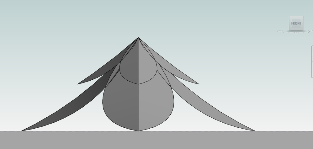

HI all, an auto cad colleague ask me to do a model of a house that is reminiscent of ancient castles. I am having trouble with what i would call a spire point roof. I have included the dwSpire problem.jpggs of the roof and a photo of the current model. I have Tried both roof by extrusion and a Massing model to convert to the roof. any suggestions are welcome.

Try to import it in an in-place model, sometimes it gives good results.
You can try to import it inside a family too.

Are you referring to the Arches? You can model those arches with the Beam tool.
I see the dwg now. Sorry. That  can be done using the Revolve Tool -- pretty sure.  At least a major portion of it. Spire.png
I just imported your CAD into a Generic Model Family and created a Revolve by tracing (using Pick Lines). Easy breezy. 99% done.

Create an in-place model with the category Roof and create a revolution based on the CAD you've load in your file :

If the below is what you are talking about then you can try a mass and roof by face to create 1/4 of it then mirror to get the entire roof.

I don't think I have ever modeled anything like this before either, but it's hard to know for sure. I can't make sense of the design from just the Elevations and Plan View you provided.  I would need to understand the shape/construction  better before I could model it.  A photograph would help.  If you can post one, we can figure out how to build this Spire in Revit.

It looks like two layers of leaves, like a up side down flower.  But the plan and the elevation don't correlate so it's hard to proceed.

A start.

See the screenshot sequence and the 2019 file.
