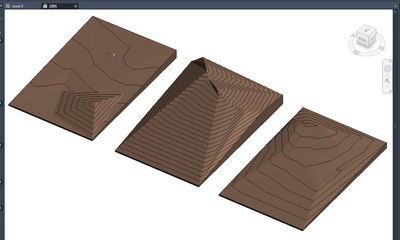

Triangles show even on Enscape visuals and shaded views. At this stage still have to keep the old imported toposurface in my models- with no option to edit it, not ideal. Am I missing something? How can I get a smooth toposolid?

Seems like I can't create any smooth topography from Toposolids, even very simple shapes. See attached, triangulation shows even on shaded mode, I think I  am missing something.
