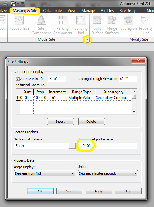

I have an ssue regarding topograhpy. When in Section view it will only show pattern  in one lelve, but it won't go bellow my lower level. What can I do?

try this:
  • in Section View > Massung & Site - Model Site > click on the small bottom-right arrow - Site Settings
  • in new opened Site Settings window > Section Graphics > Elevation of Poche Base  - change the value as you want - deeper as it is by default...

Thank you Mr. Stroescu. You trully are the MVP (Y)
