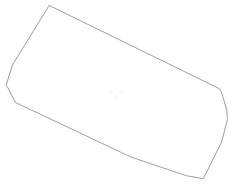

Hello everybody,
I have some issues with a topography model. The topography 3D model was made with COVADIS then exported into an IFC file in order to link it into a Revit projecttopo_01.jpgtopo_02.jpg.
However, into my Revit views only the perimeter of the topography appears. After to have manipulated several settings (parameters, visibility/graphisms...) I didn't manage to obtain relief visibility or platform visibility like we can see into the 3D view and into the native file.
Does anyone know how to deal with topography visibility from an ifc linked file into Revit?

is that actually modeled? Looks like 2D linework from here.
Wanna post the IFC?
