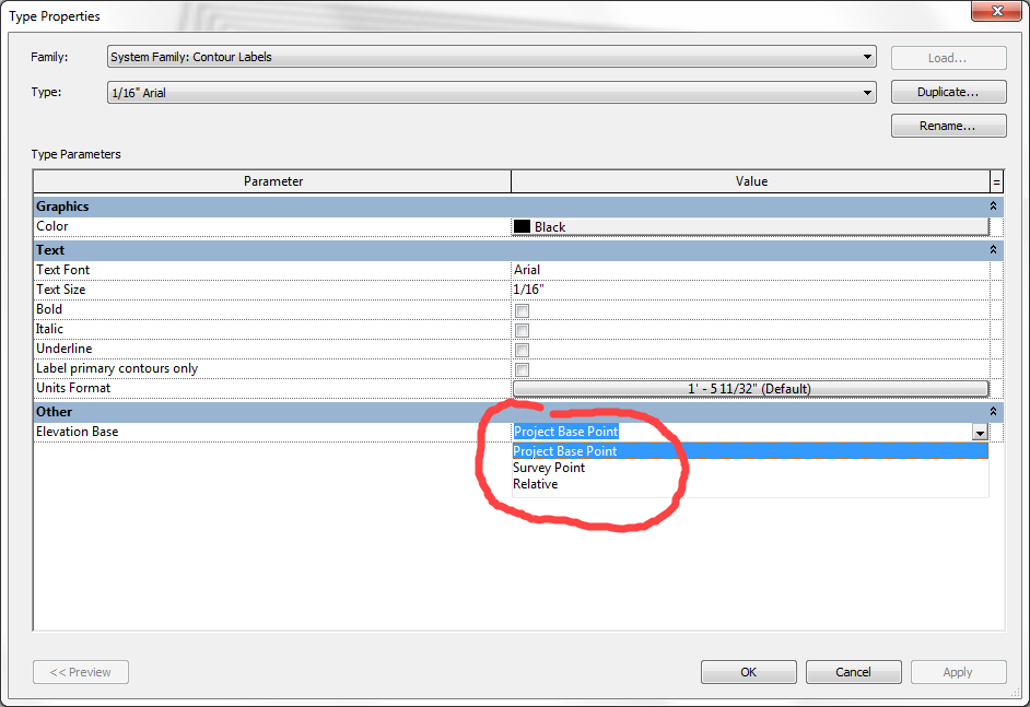

understand that the points elevations (the one's in sketch mode) are relative to the Internal Origin of the Project. The Internal Origin can be found by right-clicking on the Project Base Point and selecting "Move to Startup Location".
Also, be aware that the Contour Labels are relative to an "Elevation Base", as shown in this screenshot:
So, to correct yours, you would go to an Elevation View and move the elevation of the Topo 21 ft., or move the Level  that is the Contour Label's "Elevation Base"  21 ft.  Moving the Topo would be best.

I would recommend this workflow:
1. Place a Level at the Internal Origin and name it "Sea Level". Again; the Internal Origin is where the Project Base Point's Startup Location is located.
2. Import CAD
3. Create Toposurface from Import
4. Go to an Elevation View and lower both the Topo and "Sea Level" Level together.
5. Pull a dimension between "Sea" Level and "Level 1" and lock it.
6. Set your Contour Label's Base Elevation to "Relative" and set the "Relative Base" to "Sea Level" upon placement of Contour Labels
...based on what you wrote, you would lower the Topo and "Sea Level" 6533 ft. in step #4.
