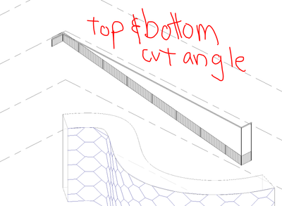

As the topic title, what is the difference between the top/bottom cut angle and the slope angle within a baluster family? I seem to get the same effect when I interchange them for railings on stairs&non sloped ones but I get a different effect if the railing has a height adjustment and slope inbetween.

After a bit of investigation, I got a better idea on what's occuring.
- For most railings in most projects, slope angle equals top and bottom cut angle so I didn't notice any difference of using one or the other
- The exception is as above when the top of the railing has a varying height relative to the bottom of the railing.
- There appears to be a bug in where if you use the top cut angle over the slope angle, the top cut angle reference plane becomes dissassociated with the height of the baluster panel but is still associated in the family editor. So it does flex with the height parameter in the family editor but doesn't when I load it into a project. All I did was change the label from "slope angle" to "top cut angle" and "bottom cut angle". In the example above I just created a simple extrusion that I constrained to the 4 reference planes.
- I did find a workaround to the issue. I created two reference lines that begin at the intersection of the planes "Top/Bottom Cut Angle" and "Center front/back" and then continue on at an angle defined. Basically they replaced those two reference planes then I aligned all geometry to those reference lines. Then everything worked as I expected in the project.
Has anyone dealing with railings/balusters experience this issue?
