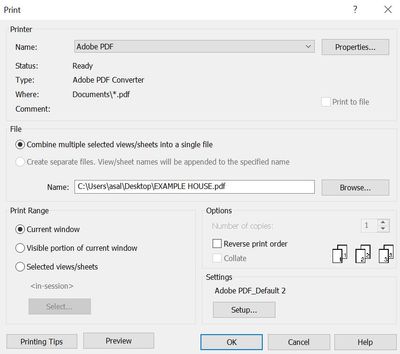

Nachricht 7 von 32
Nachricht 8 von 32
arshad.k
als Antwort auf: asal_keyhani1993
hi @asal_keyhani1993
Try using Microsoft Print to PDF instead of Adobe.
I too faced your issue, like you I use an external application PDF24 creator to convert PDF,
So it also makes lines too dark and then I change my Printer to Microsoft, My problem gets solved.
So try it once.

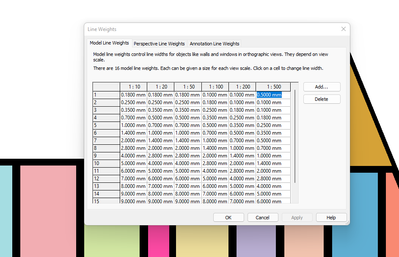

Nachricht 12 von 32
now The line weight is a bite pale
Nachricht 13 von 32
arshad.k
Hi, @asal_keyhani1993
Ok then Control using Scaling and Fix it.

Hi
you mean i should changed the scale again ?
Nachricht 15 von 32
arshad.k
Keep your old scale size and change line weight.
Hope this helps!!
Change Line weights according to your scale size.
