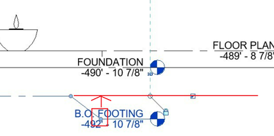

The level height messed up
Hello
       How to solve this situation? The level height messed up.
Thank you

I assume this B.O. Footing level is jogging. You can put it back to the original if you click on the circle grip and move it to the horizontal level.

I mean the number is messed up, eg:  Footing should be -2', now it shows -492'
How to make the correct number back?

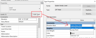

Check the level type and switch to elevation base to either project base point or survey point.

Thank you sososososo much
