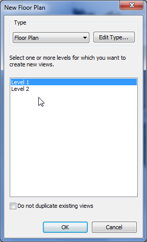

Go to View Tab=>Plan View=>Floor Plan and select Level you want to create a Floor Plan for.
BTW: You need to be in an Elevation or Section View to create a Level.

Success! Thank you so much for you quick response and assistance.
