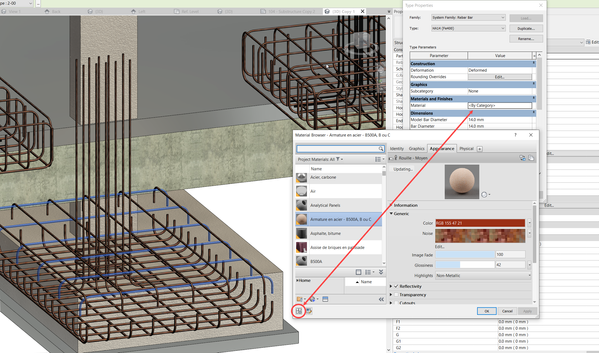

hi , i have black rebar , they don't look like 3DScreenshot_3.png, don't know why , any help
the render is at realistic
detail level Fine

thank you for your answer , but nScreenshot_7.pngScreenshot_8.pngothing changed , i tryed the yellow color but still the same

Scroll down to "Tint" and apply a color.

still the same thing
i thing it has somthing to do with light, you can see the color on the top of the rebar , but it's just too dark,
i don't really need any special color , i just want it to look brighter than it is right now, the default setting will be fine

Is your view phase Filter set to Show Complete?
...just to be clear, you are viewing REBAR Unobscured; right?

You may have another Override acting on the Rebar that is higher up the food chain...

for the phasing it's on "show complet"
i dont't really undertand what do you mean by unobscured but i tried to change the material to another one and it worked
but i have to change it from the edit type, and in that case i have to edit all the types of my rebarsScreenshot_11.pngScreenshot_12.png
tried to use the same material in he Object styles but it doesn't make any change
