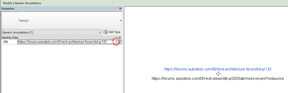

You cannot add Hyperlink to a Text note.  But you can add a Generic Annotation family with an URL parameter.  Highlight an instance of the family, click on a button on the Properties and it will bring you to the designated address.

Thanks for your time and the answer.
So there is no way in you can click directly on a link in a view right?
 like clicking on what u see in the iamge.
