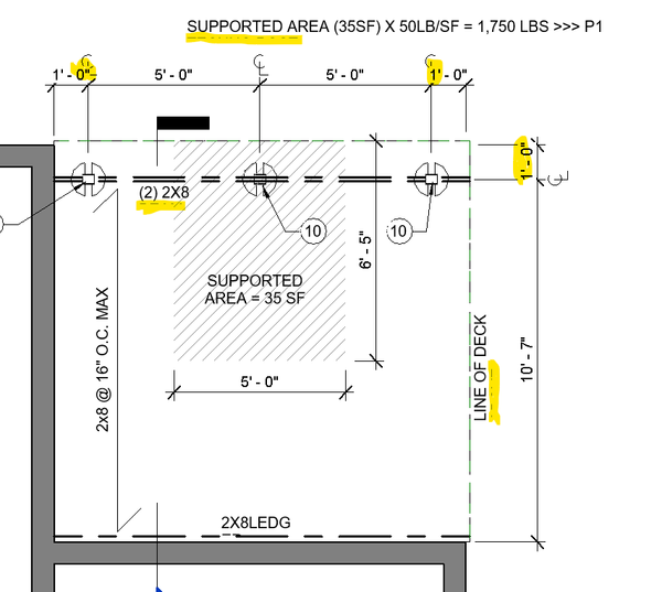

We're having an odd issue with text size appearing differently on different computers.  It looks like for some reason the text is... SLIGHTLY... larger on my computer than it is on other peoples.  It then forces the text onto multiple lines and cuts it off.
The two screenshots are from the exact same model opened on two different computers.
When I edit the text Type, change the size, and then change it back, it appears correctly.
What might be causing this?
