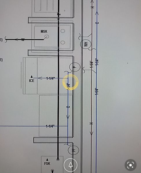

Guys, my first time encounteref this. Label for piping look ok on RV view, as attached. In print preview they lost the intended opaque background, same result in PDF outputs.
How can I fix this ? Thanks.
Will this be "bring to front" issue ?
1 ANTWORT 1
Nachricht 2 von 2
als Antwort auf: yes_and_no
Change the View Detail Level help?  Hidden vs Wireframe?
