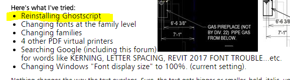

By the way, why do you need to install Ghostscript?  I don't remember I have ever had to do it for the last 10 years.
Message 10 of 21
Toan: what are you getting at? I'm not following you. Maybe I'm missing something here. I thought we were talking font installation into Windows font directory - something I've done a lot in 10 years.
Message 11 of 21
From his initial post:
Message 12 of 21
cuttingedgeplumbing
I thought it was a requirement for PDFCreator (one of my PDF printers), and if most of the PDF printers used it, perhaps a reinstall would reset something. Alas though, the reinstall changed nothing.
