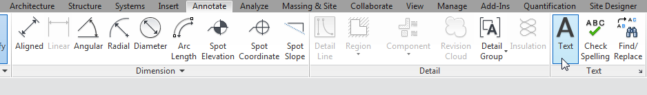

So I have fully committed to convert to Revit, coming from my AutoCad Architecture 2018. I’m hoping that I just overlooked something obvious?
Where are the text editor options for multi line text? Bullets,Numbering,Multilevel list?

There are different ways for adding text in Revit (e.g. Model Text, Tags, Schedules, Text .. etc.)
I think the part that you're asking about is the Normal Annotative text ( You can find it: Annotate--Text--Text )
2018-03-14 10_26_12-Autodesk Revit 2017.2 - [3D View_ {3D} - LW Cubes V8_MEP].png
This is the way to add annotation texts to a 2D view "only", it's automatically scalable with the view scale, and it's a view specific element ( that means it will only appear on the view that it belongs to )
