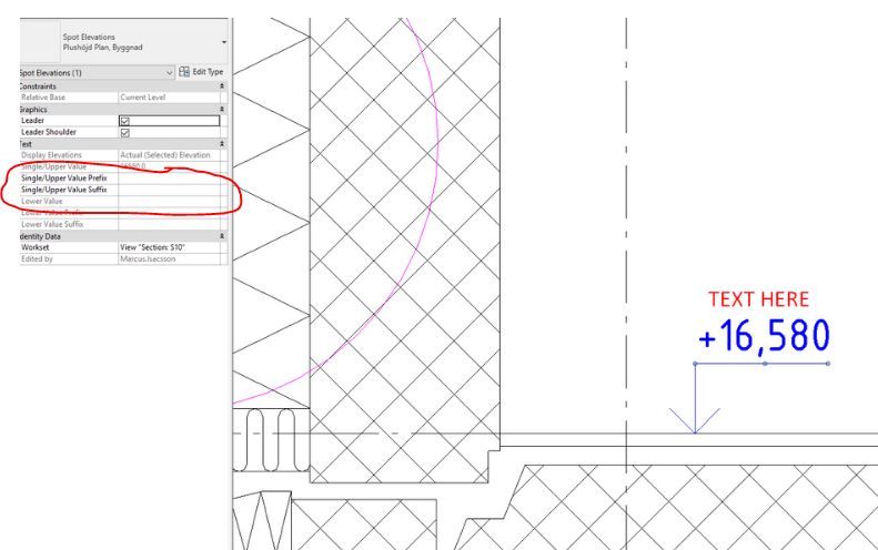

Hi fellas!
Is it possible to add text above the 'spot elevation' as a part of the tag somehow?
We want to add the level information (manually or automatically)

The text doesn't appear above the elevation mark, it appears before the +xx.xx.

Custom text above each plus height, "Level xx"
