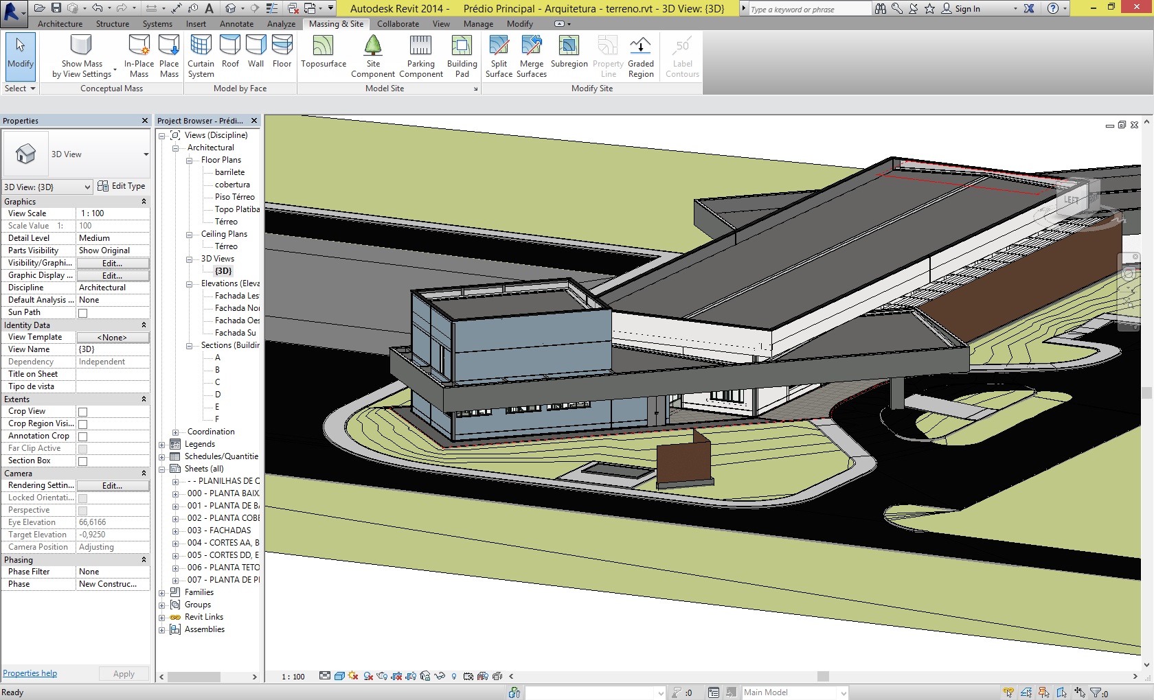

Hello Revit friends,
Having problems customizing my terrain appearance on section views.
Learning from this and other online Forum's, I could dig on advanced settings:
Starting from drawing toposurfaces, and making sub-regions with different material properties, I have tested:
  • altering the view Visibility/Graphic Overrides options for Topografy Category
  • using the different Model Display options in the view properties
  • changed the Far Clip options for the view
  • altered the viewRange, by selecting it in a plan view and edditing it to make sure it overlaps the toposurface region
  • altering the object Styles for Topografy category
  • edditing the Site Settings > Section Graphics > Section Cut Material and Elevation Poche Base
After all this I culdn't be able to configure TopoSurface to appear, at my section views, with a thick cut line, earth pattern for cut pattern (between cutting line and the poche base height) and thin lines for surface border lines.
What I want to see is my building elements cut by the section, and my terrain cut by the section. The building elements and terrain that are not cut, but are within the View Range, should appear when they are not behind cut stuff.
The View is set for Coarse and Hidden Line Display Settings. But that's not necessary, if it should be any problem.
I made a Filled Region to satisfy my needs, but obviously that is not the way I want to solve this.
Take a look at the images attached for ilustrating the problem.
Thanks for the help, and sorry for the eventual basilian english errors!
