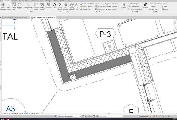

A simple floor plan task should not be this hard. I have a floor plan with tapered walls, which also happen to be radial/curved. Revit cannot clean the corners, no matter what I try. Any  advice?

Post the file here.

Here is a new file with the wall and geometry in question. Thanks for looking into it.

I just figured it out. I had the variable thickness material/component minimum thickness set at the top, so apparently that was throwing everything off. When I changed it to minimum thickness set at the base, then it cleaned up.

It's better but still not quite right.
