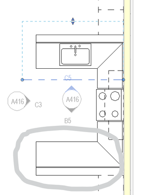

Okay, I have a good one here. I have a family with nested casework that has symbolic lines to designate cabinet openings. For some reason, the symbolic lines are showing up on both the front and back views. The view is set to Hidden Line and Draw in Foreground is checked:
Front:  lshannonEQEBT_0-1596126073760.png  Back: lshannonEQEBT_1-1596126079650.png
I have tried to make a masking region that  is attached to the back plane of the cabinet, but it hasn't worked. I may be using it wrong though.
Now, my second problem is that these symbolic lines also show up in my interior elevation views in the full model, even though they are behind the actual view area of the elevation (3d view provided so it is easier to see what is supposed to be under the sink, i.e. nothing):
Thoughts?

@ToanDN do you mean unchecking the Foreground checkbox? I have tried it both ways, and it still shows the same.
@barthbradley THe hidden line vs wireframe was the first thing I checked :leicht_lächelndes_Gesicht: It actually was wrong at first in the family, so I changed it and that fixed the weird projection onto the other side in the family. It however did not fix the issue with the lines being on both sides of the casement nested family. I hope that makes sense.
The far clip is fine, the symbolic lines are actually from behind the whole elevation. See the new photo, I circled whee the symbolic lineas are projecting from.

Make these nested cabinets Shared.  No lines.

This worked for the lines! So what does it mean by having them "Shared"?

@lshannonEQEBT wrote:
@ToanDN
Revit treats shared families nested in an assembly family as if they were inserted directly in the project and not some dead pieces in the assembly family, and that so they respect the cut of the elevation.   You can also tag and schedule them in the project.
