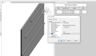

Greetings!
I would like to ask about the option of sweep in material takeoff schedule is it available only in Revit 2022 only?
thanks and best regards

@Nehal91 wrote:
Greetings!
For older version, you can create parts from wall sweeps and schedule parts.

@Nehal91
For Sweeps created using the tool Architecture>>Walls>> Wall: Sweep
Not sure about 2021 but in Revit 2020 and older version Wall Sweeps are available only under Schedule/Quantities (not available under Take Off)....however, unless you are painting each side of the sweep with a different material a quantity schedule should suffice to take off length/material/Profile/Count
For sweeps built into the Walls Structure - there is no change (still the same as older versions you need to break into parts)
