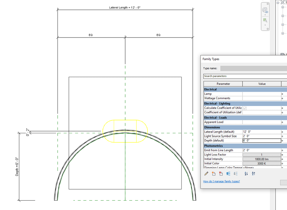

I created this family for a cove light fixture on curving walls.  I thought I got all the bugs out of it but one remains that I can't squash.  For some radii the sweep inverts so that it goes from an arc segment to a huge circle of the same radius.  How do I keep the sweep on the reference line?  I tried locking the endpoints to the planes but I get a warning about over constraining the sweep.
I had tried doing this earlier with setting the radius and arc length but that required a center outside of the ceiling host so I came up with this method.  **** it if the sweep doesn't invert at EVERY radius I need.

Can you give me an example of a condition when it happens?  It seems to be working properly here.

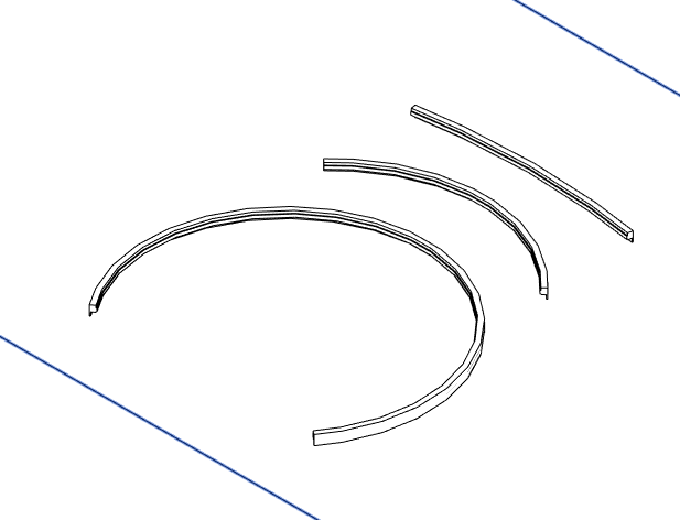

I can't figure out what the break point is.  If I place it on a large enough ceiling and drag the depth control I can make it flip back and forth from arcs to circles over a wide range of radii.  It's like there are some radius to arc length ratios it likes and others it does not.

I am having great deal of difficulty understanding what you’re trying to achieve.
I understand that this is a cove light family, and that you are placing it on a flat ceiling (e.g. the family is ceiling-based).
The flat ceiling that you are placing it on is bounded by curved walls, so I’m guessing that the sketch boundary of the ceiling is curved as well.
The family has a chord length parameter (“Lateral Length”) and an arc height parameter (“Depth”).  Those 2 parameters are not enough to find the arc segment your looking for. You need to employ some trigonometry to flex this thing. You need parameters to find angle, radius, depth, and segment.

Here a revised version of your first family.  I replaced the sweep with a sweep blend and it seems to stop inverting.

I appreciate the effort and you're right, proper control requires full command of the arc through trigonometry.  I avoided including the heavy calculations because that kind of precision isn't necessary.  But this wouldn't have solved my problem.
The problem is Revit's programmers left something out that tells it what side of the circle to draw the path of the sweep.  I know what side it's supposed to be on, but mathematically either side of the circle satisfies the requirements of the geometric constraints.
They could have used the insertion point as an absolute side for the handedness of the sweep, but this would have probably made arcs on the other side if desired by other users impossible.  A positive or negative value could have established the preferred side relative to the insertion point.  Instead, something less determinable is affecting the decision of what side is used to establish the sweep.
