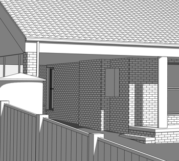

I'm using the default (Masonry Brick 75x225) fill pattern for the walls' foreground surface pattern, and the default (Spanish Tile) fill pattern for the roof.
As you can see in the image below, at sharp angles (green question marks), the wall pattern gets clipped/greyed out. And while I might be able to ignore those, I DEFINITELY can't ignore the roof. It's all greyed out in the views I need.
Mind you, if you are looking down at the roof, so the view angle is kind of "soft", the pattern will show correctly:
Please help.

Try changing your Perspective View Scale.

Set the view to Ortho, change scale, then set it back to perspective. Not sure if it will fix the issue tell you the truth.

If View Scale doesn't correct, then it could be too sharp of an angle.  It's not uncommon. Adjusting the Viewing Angle ever so slightly generally fixes it.

Thanks guys. Yes, I did realise it was the view angle. Apparently Revit clips/fades surface patterns at sharp angles. I was wondering if there was a way to set how sharp the angle can go before Revit starts clipping.

Nothing special about the export settings.  But I did change the view scale of the camera view from 3/32" = 1' to 3" = 1' to achieve the result.  I already told you how to change the scale in an earlier reply.

I already had. Multiple times.  Here is it again: change the camera view from perspective view to orthographic, change the scale to a large scale such as 1:10 or 1:5, change it back to perspective, and that will fix it.

I did try that, even before you suggested it, but the roof didn't change at all, while looking at it on the 3D view on Revit.
HOWEVER, this time around - now that you stressed it, and although the roof remained looking the same on Revit, I did export it as JPG. IT'S BRILLIANT!!!! Even the greyed out walls came up nice and sharp.
It seems Revit defautls the view scale to 200 when inserting a camera. Taking it down to 100 did the trick for me.
