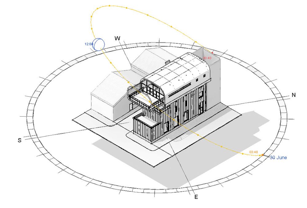

How do I make the building much bigger in relation to the sun path?  Sun path is set to 100%, I have used the Section Box to define the portion of land I wish to show rather than the whole topography but the building is really too small to see the shadows.

Message 7 of 11
After turn on the Section Box and stretch it to your liking, right click on the Sun path and choose Fit to Model.
See images below for without Section Box versus with Section Box.
