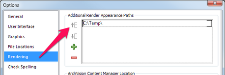

It is best to get your material images organized in fixed locations.
In Revit you can add additional paths were Revit will look for Render images. This can be found under Options, Rendering.
This can be a quick solution if your images are not all over the place.
Of course, first of all, you need to have the images somewhere on your computer
