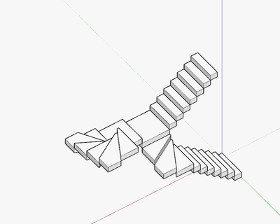

I'm really struggling to create this stair with the stair tool in Revit Lt 2022.
Images below:
I have no problem drawing the first flight up to the first square landing. But, I get stuck creating that first landing. I get errors saying 'cant make stair'. Through trial and error I've established that it'll work if the sketched landing is set 100mm or so away from the last riser. But, obviously i want to connect to the riser.
The other issue once I've overcome this is to do two flights going in opposite directions starting and ending at the same point. Is this possible?
I could always just create a custom family, but I wanted to persevere with the stair tool as it'll be quicker im sure in the long run if I master it.
Any tips appreciated!

Nothing posted,  but try deepening the Structural Depth.

You sure increasing Structural Depth doesn't work?

Ah, yes I increased it some more and its worked! Thanks!
Did you create that stair from on2 sketch or is it two stairs combined?
Nachricht 13 von 26
als Antwort auf: NP---MD
One U-Shaped and two Straight Runs up from the Landing Level.  All Sketch-Based, FWIW.

You have to use two stairs to create this complex stair. One for the u-shaped stair, and a second for the flight that goes in the opposite direction.
