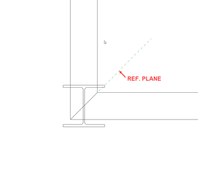

Situation - Using structural beams to form up the perimeter of lets say a flat roof situation. Its easy enough to do the beam / column join tool to produce a clean miter cut. This issue I have, is as soon as a structural column is introduced under the beams (at the corner) it over rides the miter cut, as I assume it is joining to one of the beams.
The image below shows the beams being successfully mitered with the column off to the side (still in beam join edit mode).
Once the column is positioned under the beams (on the corner), it breaks the miter. You can see the corner of the column where the miter joint would be.
Even if the column is stopped short of the beams, it still breaks the miter.
Move the column away again, the beams are no longer joined, but can be mitered again. I have tried with the beams being bottom or top justified in the "Z" direction and the same issue occurs.
I have done a search and found others with the same issue, but no resolution that seems to solve the issue.
This is exactly the same problem from 6 years ago:
https://forums.autodesk.com/t5/revit-architecture-forum/unjoining-a-structural-column/m-p/6610015#M1...
As per the user in the above thread, in the past I have cut the miter on the beams with reference planes, but they is painful if the beams move, and even more so when there is a Revit function to do the task.

barthbradley - Thanks. The trimming to a reference plane is a work around I have used in the past. Gets the job done, but not great if things are still being tweaked along the way and you end up with a heap of reference planes if you are trimming multiple beams. Revit seems to have the tools to do it better, but I cannot get it to function reliably.
