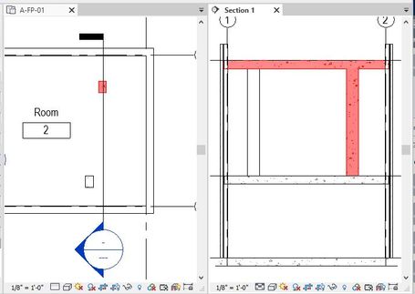

Hey,
concrete structural column and concrete floor are joined together
both are the same material, and yet i see a line "separating between them".
-tried different section view templates
- there are columns in my project which are fine ( connecting to the slab without this annoying separate line)
asking for your help guys,
thx in advance

is your section passing thru the column?

Are you sure you are not seeing the Level Line?

yes section pass through column

its not a level line ( you can see the level line in the picture above the floor)

Firstly unjoin them and make sure they are detached then join them again.

it worked ...
