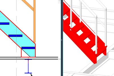

is there an easy way to adjust the start and end stringer profile so that it would represent the real connection detail? The below screenshots show a u-profile stringer with red line representing the desired end profile / cranked stringer.

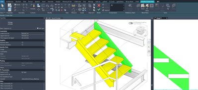

@pavankumar.h@mari.shimode  thank for your reply, but can you please tell me where exactly is the edit path tool for a stringer? You can highlight it on the below screenshot. I have truly never seen such tool.

Create the stairs without stringers and for the stringers use a structural framing element. You will then be able to use steel connections, welds extra. This will give you better results and will give you to the detail you posted

@RDAOU thank you, I did this in few instances before, but I wanted to see if there is another way without having to model stringers separately. Hopefully @pavankumar.h will shows us how.
Message 8 of 14
RDAOU
@Karol_Piroska
Stringers Path is not editable…only it’s sketch line
If you do not wish to use structural framing, you need to model the stair without supports and substitute them with a HANDRAIL (using Top rail as stringer Left and Handrail 1 as Stringer Right). Handrail allows you to drop the profile down to the floor using:
  • Either extensions or terminations which do not require editing path
  • Or TAB to select the rail and edit it which allows you to extend the rail's path vertically downwards
Either ways, it will not be stringers you are working with it will be a different Revit element. I would still go with Structural framing to be able to add the flange and bolts to the ground as connections
Edit: See GIF below
Rail set up looks as follows:
To select the Rails and edit them, Select Pinned Elements need to be checked

The "Edit Path" tool for a stringer in Revit is typically used to modify the geometry of the stringer, like its path or alignment. However, upon examining the screenshot you provided, I don't see the "Edit Path" tool directly visible in the ribbon. It might be hidden or not activated because the stringer is already in a specific mode.
Here's how you can generally access the "Edit Path" tool for a stringer:
  1. Select the Stringer: Click on the stringer in the model to activate it.
  2. Modify Ribbon: Once the stringer is selected, the "Modify | Create Stair" tab should appear in the ribbon. This tab includes tools for editing stair components.
  3. Edit Path: Look for the "Edit Sketch" or "Edit Path" button in the ribbon. It is usually located under the "Tools" section.
If the tool is not appearing, consider these possibilities:
  • The stringer is part of a predefined stair type and does not allow direct path editing.
  • The stair component is locked or constrained by other elements.
You might need to switch to a different stair editing mode or check if the stringer is editable by selecting it and looking for options in the "Properties" palette or the context menu.
Since the tool is not visible in the screenshot, I am unable to directly highlight it.
Please let me know if you need further assistance or clarification!

I'm sorry @pavankumar.h, but I truly do not understand to your reply and notes regarding "stringer being in a specific mode", "The stringer is part of a predefined stair type and does not allow direct path editing" or "The stair component is locked or constrained by other elements", "switch to a different stair editing mode" etc ...
Honestly, how? Are we talking about Revit? I feel like that there are some mysterious editing options, buttons and properties I am not aware of.
Can you or @mari.shimode  please share a quick video or a gif that will show not just to me, but to others as well this "edit path tool for stringers" because to be really honest, I do not recall ever seeing it and I've been using Revit for good 15 years. I'm sure that your video will be very helpful to all, looking forward to it. Just as a test, I tried that with ootb stairs in ootb template too - and no it doesn't work in my world.
