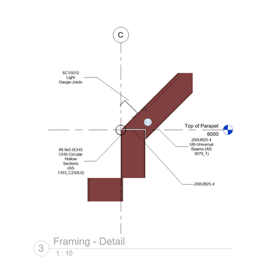

Dear All,
Maybe someone can help me explain what these squares in revit mean. You can find them in the upper left corner of the view. Sometimes I can see four of them and sometimes one.
Since the appering of the squares the rendering of the model has become worse.

Thanks for your reply. That's indeed a nice little sheet. But I mean the four purple squares. Like I said i think it has something to do with the rendering of the sheet. Because when I am panning I see one square instead of four.
Regards, Mark

But the squares are consistent trough al "viewports", so I can see them in sheets, floor plans, sections e.g.. They are not selectable. When panning I see one, when doing nothing I see four.
At the same time the squares appeared rendering started to  behave strangely. For instance:
Correct rendering:
Rendering after clicking or selecting:
I think there is some sort of relation between the two issues. I tought the squares are some sort of indication for something. But searching the internet didn't help me also because of Revit four purple squares is a vague search term.
