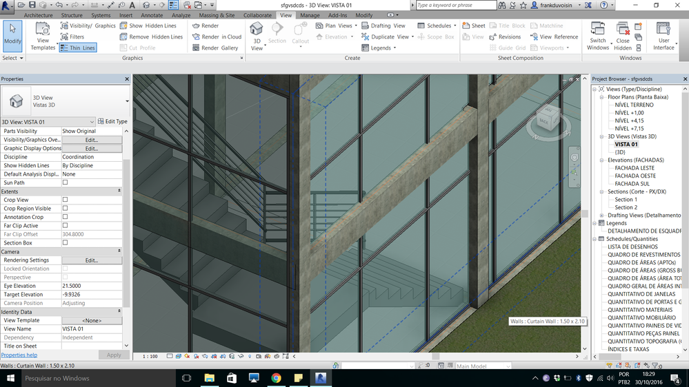

hey guys, i'm doing my first real project on revit and i'm having problems with those  orange lines. they appear in the structure... how can i turn it off?

Welcome to the forum.
Maybe the orange lines are the analytical lines of the structural members. Click on the button indicated in this image to turn off the analytical lines.
