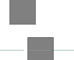

I am trying to draw the wall so it stops at the green line, but It either snaps up (like the phtoo), or snaps to the other side, but it doesn't end where I want it. How can I get the wall to work properly? I can't use split tool either, it does the same.

Click the wall. Right-click the dot at the end of the wall and choose disallow join. Then place it on the green line.

Thank you very much
