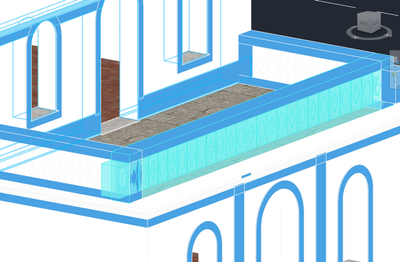

Hey! I made a railing that has corner balusters, however the starting one starts before the actual railing line. I tried changing it to justify at the beginning, center, end, spread; extende or decrease the line; but the result is always the same. The line is 10.000mm, and each baluster is 400mm, which divided results exactly in 25.

I forgot, but here are the baluster settings:

Line 2=200
Line 4, Pattern End=200
