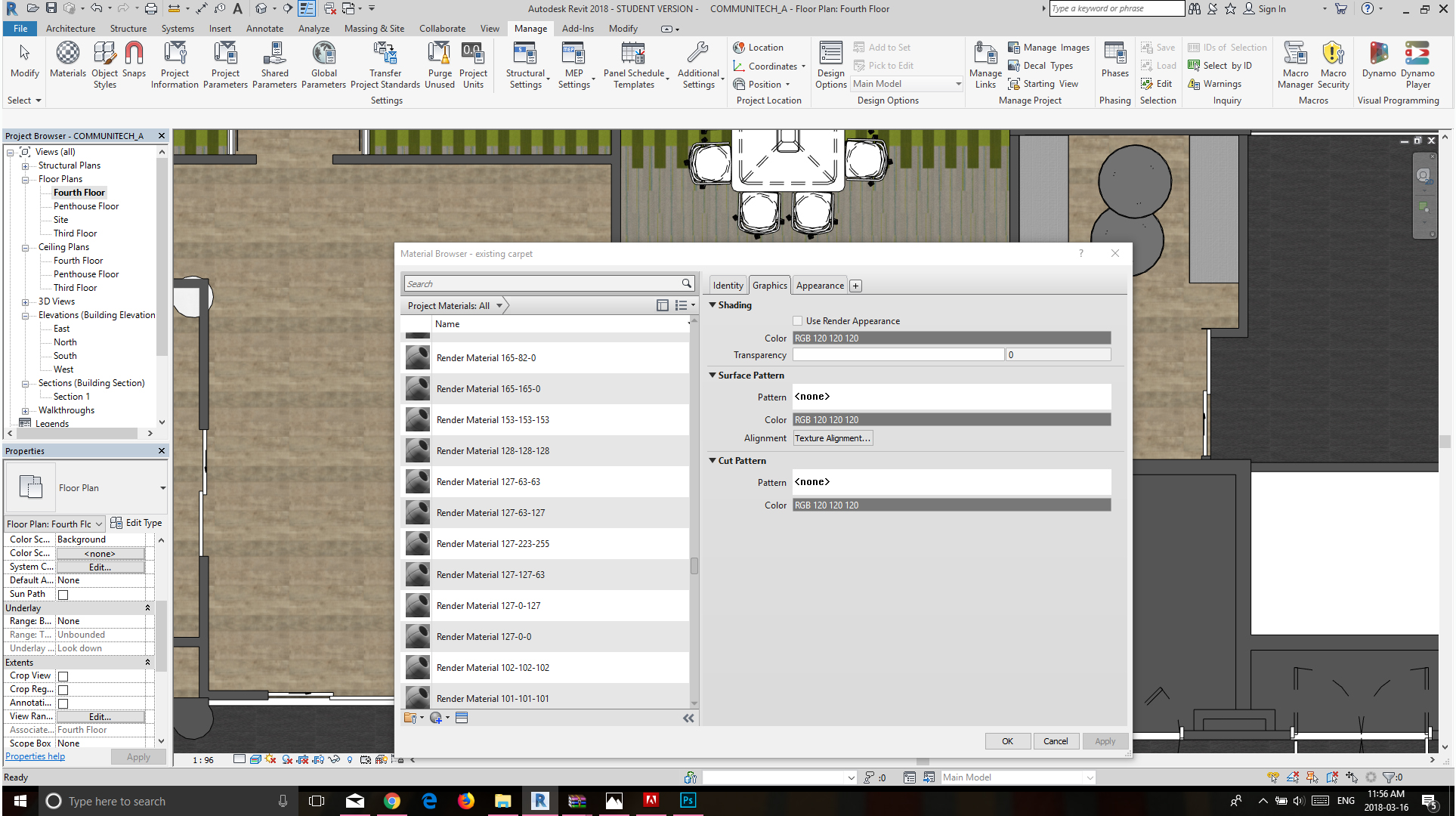

I've been placing Steelcase furniture in my project but non of the finishes are showing both in floor plan and 3D. So I clicked on the materials tab and notice none of the finishes are illustrated there. I've been trying to download Steelcase's finishes library  into the model thinking it's the issue but It wouldn't let me. If anyone know what I'm doing wrong and how to fix it please help me.

After down loading the Steelcase Revit Material Library, you should load & adding Material in your Revit model. There is (2) files 240x240 file and adsklib file. Save in your local drive. The info of how to load Material Library into Revit model is described in the PDF document which included in Revit Material file.
"README_Steelcase Revit Material Library.pdf"  See attached pdf file.

That worked. Thank you so much! I really appreciate your help.
