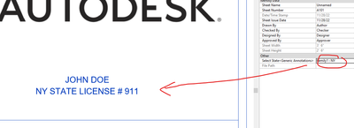

Not sure if this has been asked and/or answered, but i was wondering if i could use a lookup table to populate an architect/engineer's license information by state onto my tile block.  Right now i have to create different family types with their name and license number for each state (ie: John Doe (NJ), John Doe (CA).....).  I was hoping to just select what state the project is in and who is going to sign it and the correct license information would be populated.  Any thoughts if i can use lookup tables for this? of if someone has a better way?

You can create different types in a generic annotation family, or different generic annotation families, each with a license, nest it (them) in your TB family, create Family Type <Generic Annotation> parameter so that you will have a drop down list of licenses to choose from.

We print the name and license number for that state under the seal location.  it is more for raised seals like NJ, but are considering adding it to all drawings.  we currently do what ToanDN suggests, i was just trying to make the list smaller because we have several people licensed in several states.  Thank you for your help!
