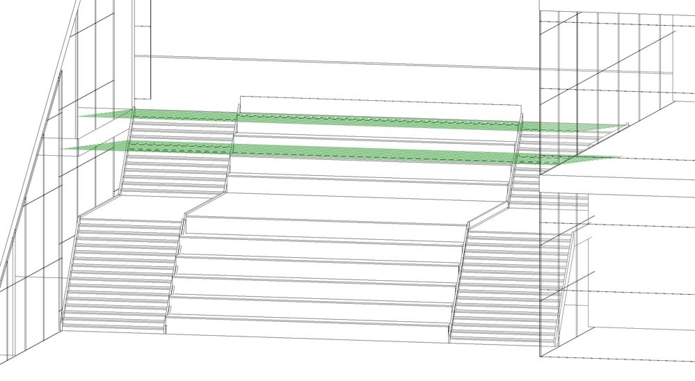

Hi! I'm facing a problem of the staircase.
I want to make a walkable roof with stairs like I drew in AutoCAD
and I created 3 different of stairs, but because of the different level of the stairs, the stairs dont join together.
How can I do it faster and more accurate?
Thank you!

Well, it looks like the outside stair and the middle stairs have different riser heights. If you mean for them to all end at the same landing height, then you need to either change the riser heights, or change the overall run length of the middle stair.
