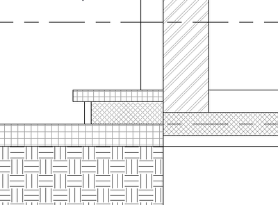

hello,
I am trying to create single step, but it is showing like in img below, it is extending beyond the tread,
I tried to change the connection method, the presentation is not correct

it is not just about modeling it, I'm using stair tool so when having a section through it, the details shall be correctly represented

Are you trying to do it with or without a notch?  Without notch should be rectangular.
...Ah, I see what you're talking about. That's the Tread NOSING.

my problem is that the step is extending inside of the wall like in attached images

I need only 1 riser but my problem is with the part marked in the red circle

That doesn't make any sense me.  Almost looks like the stair is at an angle to the view.  Post the file.

I clouded the part i'm talking abt
Nachricht 10 von 77
als Antwort auf: basma_salman
This is what I'm seeing in Section. What's not right about it?
This one? Just move the stair forward.

the treads width is not the same, one is 300 and the other is 350

this is not the issue, they are 2 different sizes :niedergeschlagenes_Gesicht_mit_Schweißperlen:

the width of the tread should be 300, anyways, thanks a lot

like this?

for the 2 steps yes I want it like that, but for the single step why is it extending to the inside of wall?

Like this?

yes exactly, did use cut profile tool or u actually worked with the stairs settings?

The file is there for you to look at.
