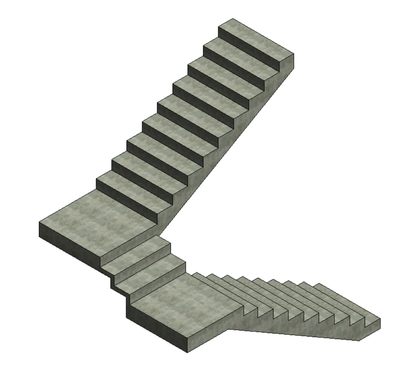

Hi. I am using Revit Lt 2019.  I am trying to create a rcc staircase which does not have a normal sloped soffit, but the soffit steps as per the steps above. I would be greatful to know how can we achieve this

Thanks for the quick reply. I should have described my problem better. My staircase has 3 flights consisting of 10 risers, 3 risers and again 10 risers in a C shape. I need the soffit to be sloping for flight 1 and 3 and stepped for flight 2. I am not able to isolate the flight 2 for this kind of condition.
Nachricht 5 von 16
als Antwort auf: bin
Well I assume it will not act as one stair in that case. So I will need to calculate the landing levels and specify them at the start. Is it not possible to have flights with different underside condition in a single staircase?

Yes and No. There will be 2 stairs, but you do not need to model them separately.
Just model one full high stairs, then copy and paste in the same place, edit and delete parts to create the one you need.

Actually, you can have the lower part and the upper part as one stairs, and the middle part as the second stairs.
If it's me, I will probably just model it as a single stairs, and somehow use model-in-place or even just detail line and filled region for some detailed drawing. At least the stair Arrow/Step number/Tag will work properly.

Sounds to me like you are trying to make the stair numbering work, at the expense of making the model accurate. What you are describing is different stair types.  That is most likely how they will be fabricated and delivered to the job site -- as individual precast flights.  It's not going to be monolithic.  Each flight is going to be supported and fastened in a prescribed way.  Model it that way and find a workaround for the stair numbering.

I have an idea, how about modeling the stairs very thin, like just having treads and risers, then use model in place to model the structural part.  You can have the stairs with normal depth to help modeling the base part and change it to “thin” style after you finish.

You cab create two stairs and set the Start Number of the second stair to whatever you want to match the firs stair.
