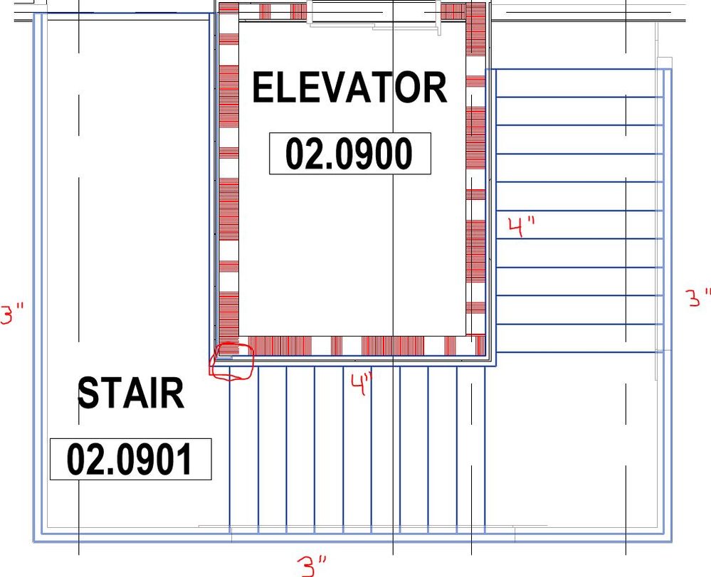

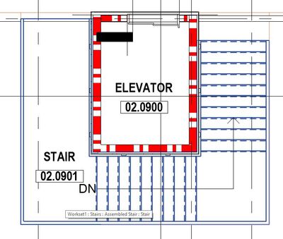

I've come across this issue as well where I've programmed one side with a 3" tube steel stringer and the other with a 4" tube steel stringer. For whatever reason I cannot comprehend, the side I need to be 4" tube steel has two lengths that are 3" tube steel around the larger of my two landings.
You can see where the blue outline jigs in the left left corner of the elevator.

I don't understand your description. Are you saying the Stringer diameter is not what you expected (e.g. 3" vs. 4")?  If so, have you verified that the Profile assigned to the Stinger is correctly drawn in the family?
Also, you can post the RVT here for us to examine.

Correct. From where I circled onward, Revit modeled the 3" stringer instead of the 4" stringer when the settings should be assigning the 4" stringer. There are 7 stringer elements and 5 modeled correctly as intended.
I double checked both profile families and both were correct. Is there a way to edit stringers on an individual basis instead as a left and right function through the stair edit? Or is there an independent location to edit the landing's stringer because that is where the issue occurs.
I exported the stair in question to a separate model. Please see attached. Thanks!
