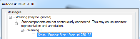

Due to core shape, the following stair needs to be modelled as the image below.
Stair looks ok at floor plan but in 3D it looks different. A hole comes up on one of the half landings.
Workaround was found by breaking the stair and, hence, creating this warning.

Edit stair.
Delete last run and landing.
Edit intermediate run. Drag grip to remove last step.
Add last run again.
Convert half landing to sketch.
Edit landing sketch. Adjust half landing as image below.
Adjust landing relative height to accommodate +1x riser height.
Convert intermediate run to sketch.
Add missing step.
Adjust landing height again to correct landing relative height elevation (???!!!)
Finish stair
Add in-place component for missing triangulated infill between intermediate run and landing.
We are very keen on having as few warnings as possible in our projects but could not work this one out.
Would have you done it differently?
RVT File attached with problem stair and workaround.
Many thanks.

oh!
In short...you uncheck the "Same as Run" and set the thickness as a Tread, as in the image below.
Much better than my workaround, yes.
