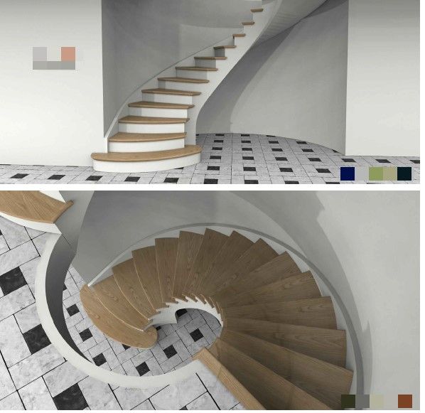

Hello I'm trying to do a stair with the following design but I can't get it to work, Can someone give me an idea How can I get this stair done?
Maybe is easy and I'm just burned already from the day, but I can't find the solution, this is giving me this error and it's not even showing me which part exactly Revit can't do, I tried taking out that first step and it works, but that step is part of the design so I can't take it out.
Thanks for your help!
Revit 2019.2, Windows 7

Boundary is wrong. You got riser wrapping around it.

Connect riser lines between the left and right boundaries

Oh! I see, but unfortunately this is not a solution in this case, because I have to follow the design and that changes the design.
Thanks anyway!! I appreciate your time. So far I build that first step as a family in place separate from the stair, let me see how it goes.
PD: The view was made by the company that does the stairs.

Model the bottom step as an in place piece.

No, I don't think you see at all, because this IS THE SOLUTION. Connect riser lines between the left and right boundaries, just like I said AND showed you, and the stair sketch will work -- WHETHER OR NOT YOU CURVE THE SECOND TO LAST RISER.

I'm sorry if I offended you, but these stairs are not the same, what you showed is not an acceptable solution for me.
If you would show it without curving the second to last riser, I mean with out changing the shape of the risers, then it might be a solution if it works.
And again thank you for taking time to help me, but if it makes you mad, then please don't do it, I won't get lost, besides it doesn't make you good.

No offense taken. Just trying to explain that you can do exactly what you want using stair sketch method, as long as you follow the rules that I demonstrated --- even with a squared off second riser. Try it. You'll see.

The solution you propose it works if the 3rd step would begin where the round of the 1st step ends (I tested), but unfortunately this is not the case (see pic), and I can't not make that change, because the stair is being built already. I'll stick to the model in place for the 1st step it's working good so far, and I can't spent more time just playing around to see how I can get it done, it will be for other project. Probably I just need to go and learn more Revit.

Oh, you mean something like this:

Can we see it in 3D?  I can sort of make it but the bottom step riser doesn't look right.

@ToanDN: Hope this works for you. This is same stair as shown in Plan View above. As you see, riser wraps fully. Stair3D.jpg
