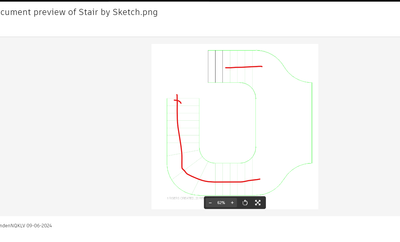

I am trying to create "racetrack" shaped stairs for a project. Think rounded rectangle. I cannot get the risers right. When I try to sketch the risers it won't count past 1 no matter how many I put in. When I try to submit the sketch, it gives me an unhelpful error message. I have tried putting the risers in several different ways (pick-line, offsetting the 1st one, drawing an entirely new line, duplicating, etc.) and nothing seems to work. I am going to attach a picture that shows 3 risers, but it only counts 1 and you can see the detail lines in the background of the shape, landing, and risers.
I hope someone can help, thank you.

the green lines is not the Riser lines this is Boundry Lines and you have not the Stair Path :
this is simple shape of your stair :
