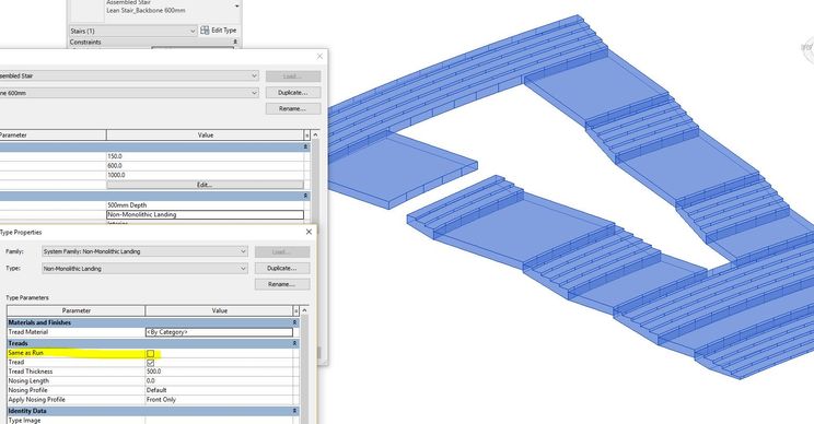

So I've run into an issue where my landings as well as one of the stair runs are not being created the way they are sketched. The landings do not show up at all and one of the stair runs consists of two risers instead of six. The stair is created by segments as it is supposed to follow a spline (which is not available within the stair modelling tools). After copying the stairs to a new file, I also noticed the landings were not even present in sketch any more. Could someone land me a hand on this?

The landings seem to have an issue when you select "same as Run". When you deselect this option and make some manual settings you can get the landings to show.
That one segment you may have to redraw (for speed i just used arcs to create the risers)
