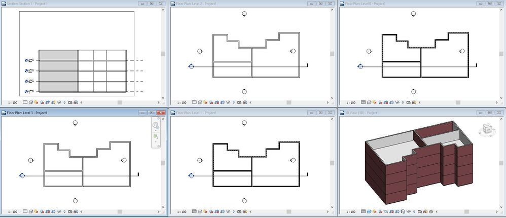

Can someone explain to me how to stack levels I have all my floor plans but I want to be able to stack them on top of each other. When I get to level 3 it is still showing my level 2 plan when it should be clear. If someone could tell me how to fix this I would appreciate it. Thank you. Below I attached a copy of my project.

I want to be able to take the floor plan on the left side and put it on top of the right but it is not grayed out like the image below. It is still showing the third floor walls and I have my elevations done. Let me know if you need to see anymore of the properties

First thing first - this is Revit, not AutoCAD. Your screenshots show all floor plans created on one view, as could be done in AutoCAD.
Window in to select the walls for the 2nd floor. In Properties, change the Base Constraint to Level 2 (or Second Floor, depending upon what you have named the levels

The problem is not having my levels line up the problem is that on the third floor it is showing my second floor walls when it should just have the exterior walls of the building showing so I can paste the 3rd floor set into that box I made. When I do what you suggest it just makes copies of that level which I do not want. I attached my project maybe you can look at it and see and I also pasted a screenshot.

In Properties - look for Underlay, and set that to None.

Change your View Range.

Your Floor Plan: Level 3 has its View Range Bottom and Depth values set to negative four feet. So of course in that plan view you can see down into the walls below.

Thank you so much that fixed it but for my last floor I'm dealing with the same issue that it is not allowing me to edit it. It is placed in the 4th floor but the view is greyed out. I was wondering if you could help me out on this last problem. I attached my project below.
1. You want stuff on Level 3 to be on Level 4 instead.
2. But you can't select it from within the Level 4 plan view.
3. So...
4. Select the stuff from within the Level 3 plan view.
5. Use the Modify > Clipboard > Cut to Clipboard tool.
6. Then use the Modify > Clipboard > Paste > Aligned to Selected Levels tool, and pick Level 4.
7. Or...
8. Toggle the setting for Select Underlay Elements at the bottom right corner of your Revit screen so you CAN select the stuff from within the Level 4 plan view, and THEN do steps 5 and 6.
9. In either case...
10. Put all the View Range settings for the Level 4 plan view back to the default values instead of the crazy values you've got in there now.
