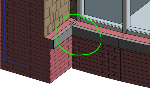

There are not one or two, but four and five problems I've had to deal with the CW. Right now in this post I want to focus on inserting stacked wall [SW] inside the CW.
The first one I have to deal with is how to insert SW segments inside the curtain wall. Has anyone done this before? When I replaced system glazing panels with these SWs (in separate top and bottom parts), they were off by few inches forward and downwards. To align them with the actual SWs next to them, I had to modify the lower wall segment's structure by unlocking the base and top wall boundaries. After finding that didn't fix the sweeps entirely, I turned these lower segments into parts, which opened a can of worms. Yes the alignments were made, but but that turned a wall into several parts.
I intended to follow the design based on this illustration. It turned out that making this would be one hectic task. Doing this in in-place was not an option for this part.
Of course, I have to deal with mullions as well as wall joins.

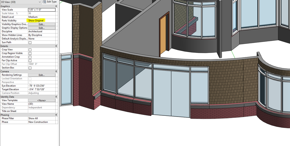

See if it is what you are after?
I just saw @RDAOU response and I agree with him.  For your design, I would not embed a brick wall with sweep as a curtain panel.  It cannot join cleanly with the adjacent wall.

Unfortunately, neither options you suggested worked for me. I cannot create the whole CW (as a single piece) into the SW and edit the individual panel profile separately. No option to edit in-place was available for each CW panel. Also, making a wall and using Wall Opening (Modify | Walls tab) would drastically change away from the original design as shown in the illustration.
But you did raise a point on a separate wall... So what I did was divide these walls not into three, but six wall segments. I had to separate a host SW into three (left, center top as stand-alone segment, right), and the CW into three: left three panels, center CW for door, and a right panel.
So that's one problem down, but another takes place. How do I clean join the gaps between these CW mullions? I know that using Quad/L-Shaped/Trapezoid works well on 45/90 degrees miter/butt join, but I really have no clue here. The joints don't come as clean in the way I wanted. Do I have to use in-place wall sweeps to disguise them as mullions? Any other alternatives?
The curved wall (as of now)
Just a test: left CW-Door join uses Quad mullion, right CW-Door join uses L-shaped Mullion.

There are no parts.  I was showing you the modified curtainwall so the sweeps align across the elevation.  I did not create parts from any of them.
@RDAOU: Thanks for your response.
I attempted using SW as host, with CW embedded into the host wall many times, with no desirable outcome (until now).
The curtainwall is segmented, frames and mullions are straight members.  It is not possible to have clean joints when they come into each others at an angle.  These joints will show in real life unless you build them with curved frames/mullions/glass panels.
