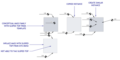

Did some testing with Inplace Mass and Mass families with simple cubes (horizontal tops) and here are some results:
  1. Inplace Masses (created from the site menu or from the Architecture|Inplace Component menu with Mass type) don't allow the top surface to be tagged;
  2. A placed instance of a Mass Family made from the default Conceptual mass template allows the top to be tagged;
  3. Copying an existing Mass Family instance will result in losing the ability to tag the top;
  4. Placing a new instance of the same Mass Family from the project browser or with the Create Similar tool will retain the ability to tag the top;
  5. Reloading the Family of a previously top taggable Mass Family instance will make it lose the ability to tag the top;
  6. Copying a previously tagged Mass Family instance and it's elevation tags will retain and update the level association of the tag even after reloading the Family but lose it's ability to add new elevation tags.
  7. Joining a top taggable Mass Family instance to an Inplace Mass will lose the ability when joined and after being disjoined from the Inplace Mass.
I can't see any logic to this behaviour.
-luc

Having a sloped top does not seem the modify the behaviour:
-luc
